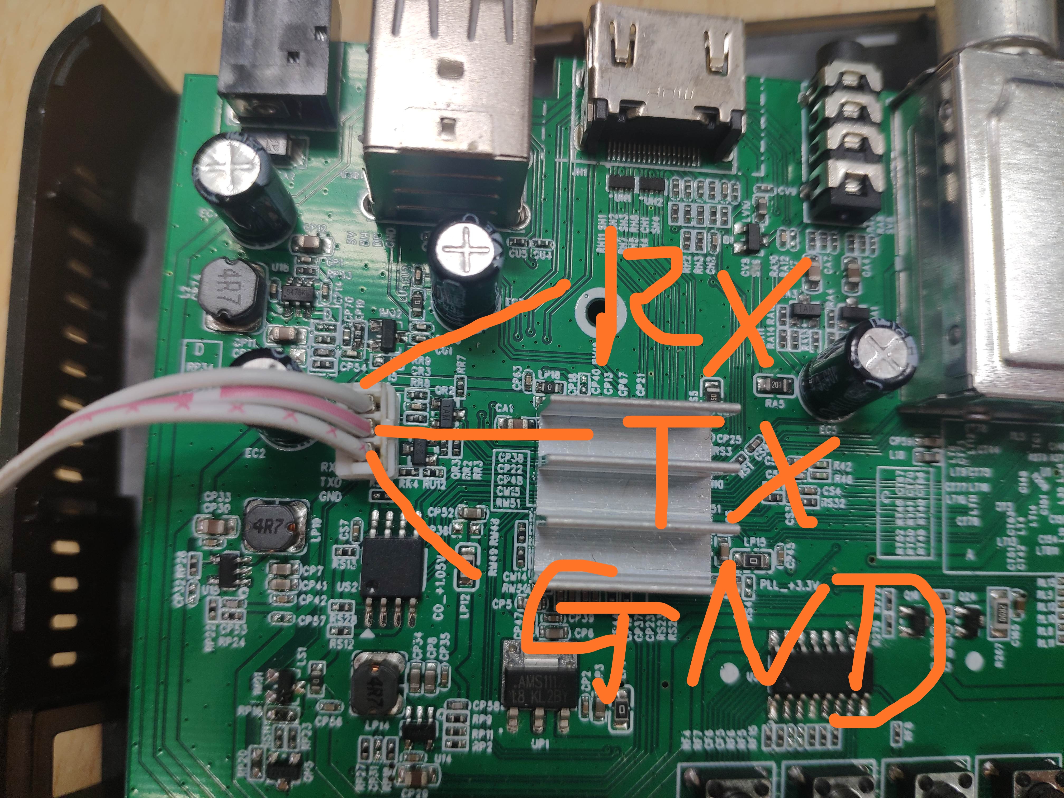

Hello my friend, why do you need rs232 recovery?
Normally you can use USB "auto_burn.fac" recovery if you can see "boot" when power on.
In case you need RS232 recovery, see the attached pic to connect an RS232 connector to you PC, and use the hellobox 8 upg tool to recover.
- IMG_20210712_100643.jpg (2.13 MiB) Viewed 4356 times

Thank you for replyinggxu wrote: ↑Mon Jul 12, 2021 2:15 amHello my friend, why do you need rs232 recovery?
