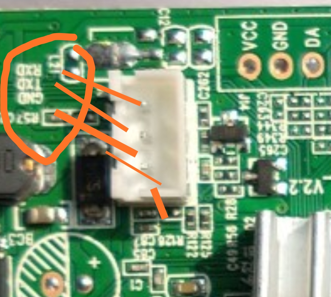

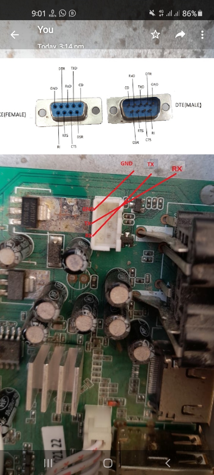

BASED ON CONNECTOR POSITION IT SHOULD BE LIKE IN IMAGE ATTACHED AND DEPNDING ON YOUR CONNECTOR TYPE LOOK FOR CONNECTION IN IMAGE.
DO IT ON YOUR OWN RISK . DONT BLAME ME FOR ANYTHING WRONG HAPPENS AS THER IS NO LABELING.STILL YOU CAN CHECK GND WITH CONTINUITY CHECKER.

Brother just change the side pic to each other don't change the center one and it will connect ok this is the main difference of GX 6605s with 1506 g boxes for serial lead method ok

Brother as you can see in image as label on board of gx605s. i made no mistake in image about connection and for 1506t i dont know. i have only 6605s board. I never talked about that board never will. I don't intend to buy that board
