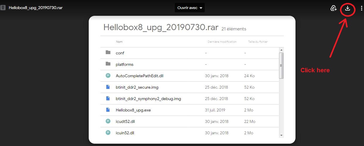

2- please load hellobox8_upg in in another host:
https://drive.google.com/open?id=1ldPlZ ... aRLpji_V-M
i can't download it.
regards
is this work like rs232 (usb ttl)
do not wait and test, there is nothing to fear...
just refer to readme_download.jpg for hellobox8_upg usuage

thank you, but when i download it, my tablet save it:
Helobox8...... rar.mhtml
the size: 1.2 Mb
not the right rar file!
please upload it in mediafire.com

the size: 1.2 Mb
https://www.mediafire.com/file/gx292hii ... 0.rar/file
