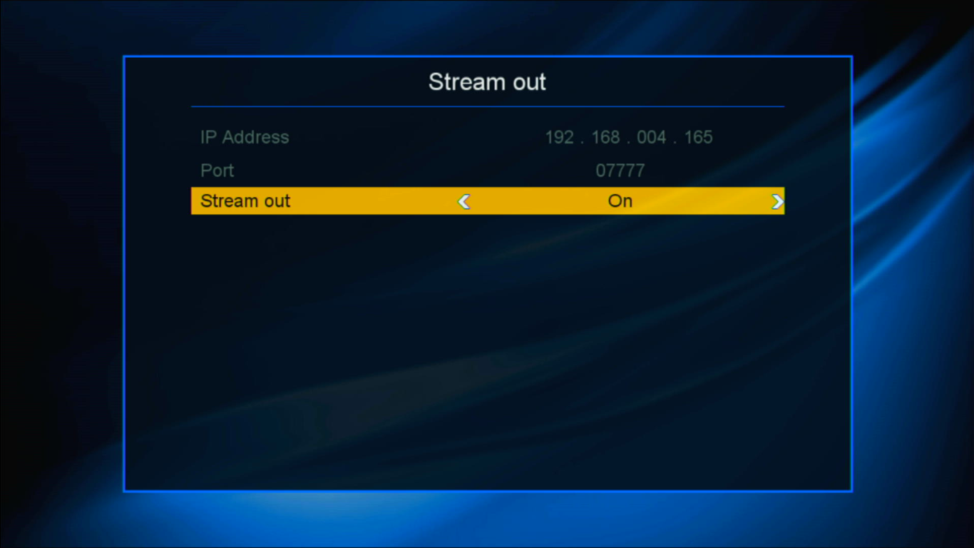

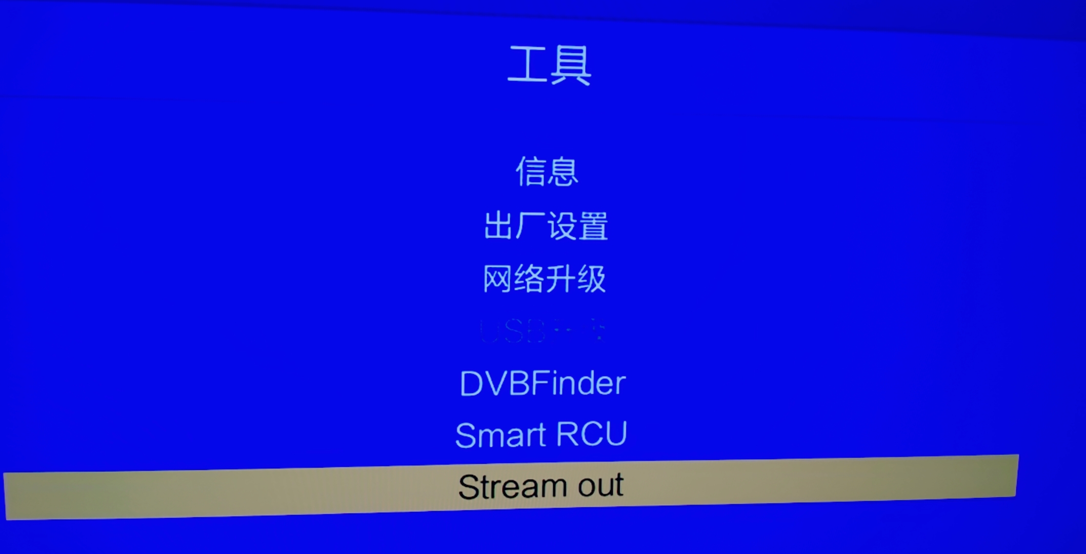

  • add Stream out(Tools) function
  • Fixed bug

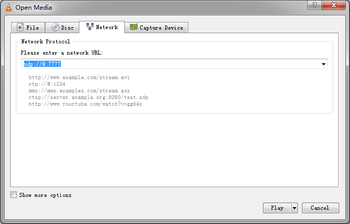

Stream out:Enter the IP address of the PC, the port can be customized, select on, and then go to the PC side to open the VLC, enter the media open network stream, and enter the udp://@:port to play the programs on the STB

I have entered IP address of PC on hellobox V8.Tired inputting udp@ on VPL media but it is not working.
So I need to be clear.Do u have spaces while putting port on vlc media?
Do u choose "play" or "stream" after inputting port?
Also how long do I need to wait for the loading to finish normally?
Ty in Advance

1.Input the IP&port of PC to hellobox
2.Stream out turn “on”
3.Open VLC->Media->Open Network Stream->Network->Enter udp://@:port ->Play
4.STB exits to full screen, and the program to be played needs to be consistent with VLC

Ko ko aung wrote:
Fri Sep 04, 2020 2:58 pm
Ty in Advance
if you switch channel on Hellobox 8, you should reselect the program on vlc/potplayer, or stop and restart
