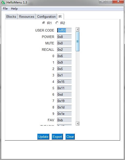

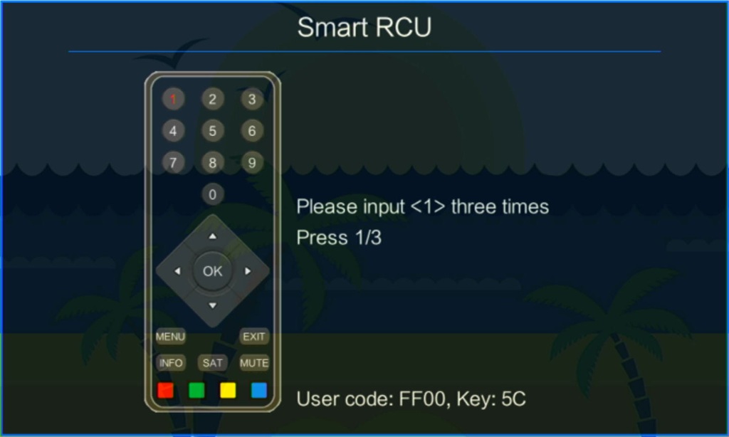

You can set a new set of keys. First of all, you need to know the key values of the remote control keys. Enter the RCU settings, press the buttons on the remote control one by one, and it will display the corresponding usercode and key. Then input these values into the tool IR to replace the original ones. Then click Update to complete the setting and save bin.
