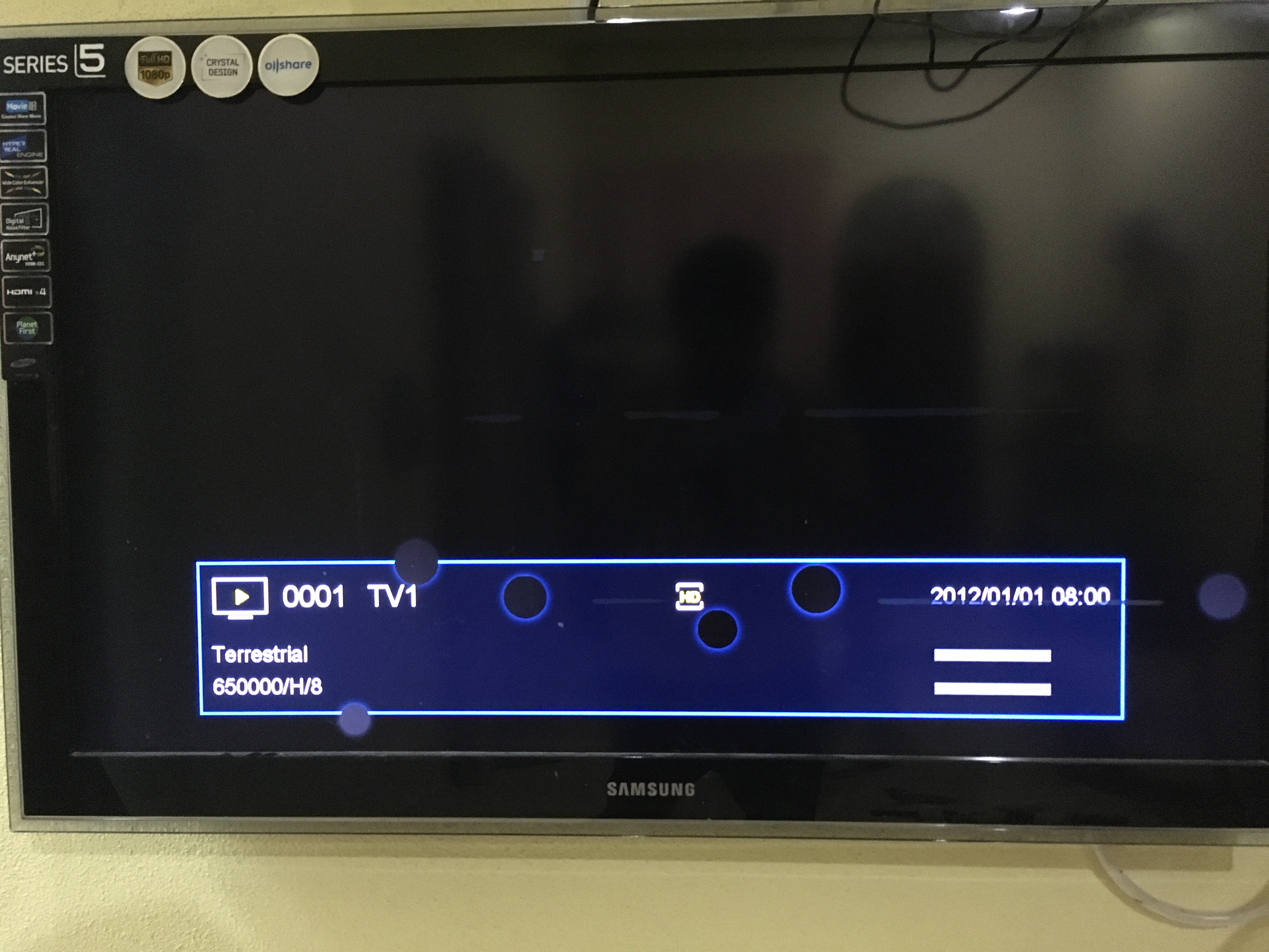

After update, take time almost one night to restore Data, and this morning not functioning.. only stay at channel 1..
what todo? Please help me..
